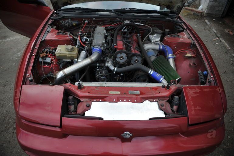

http://img2.auto24.ee/auto24/560/952/14152952.jpg
slyy2048
WhatsApp: +6281339093884
12.0s CA18DET
